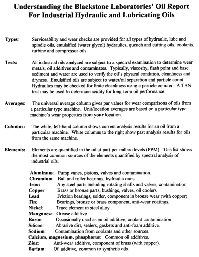

After 5,000 miles put on the Rebel, 1999 C5, having an outside testlab test the transmission fluid to see how the internals of the trannie are doing and how the fluid also is doing
Blackstone Lab's will maintain your old tests and then will compare any future fluids tests of yours to old test results
