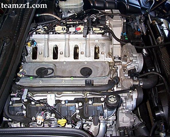

Important is that you properly torque the bolts down in the following order using Nm or inches
Once installed, it now looks like this:
