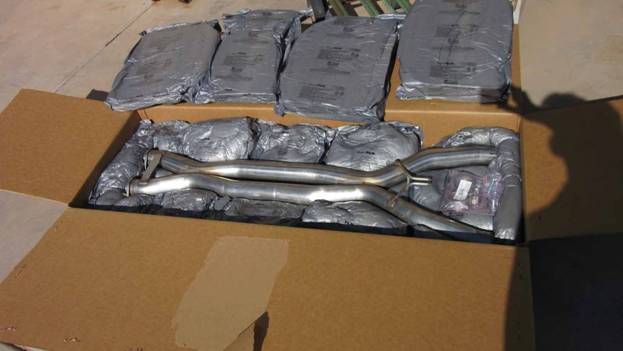

I decided to splurge and spent $600 on the destroy this….gonna the UPS guy was when it arrived it came well-packed in a casket sized box – no way

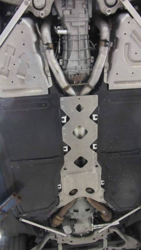

So, I put the GS up on a lift and removed the 24 bolts holding the skid-plate that covered the Stock exhaust

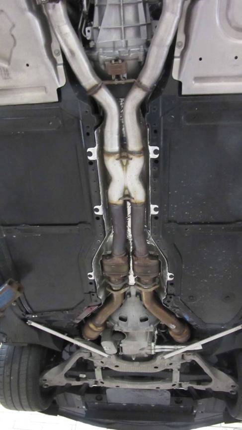

 With the skid plate removed you can see that the stock exhaust already has one X between the rear cats and the mufflers.
The front pipes are each connected to the headpipes by studs 2 studs per pipe. Easily removed – you won’t need them again.
The rear is held in place by 2 band-clamps… again easily removed. You need to separate the pipe from the hanger, which has a rubber hanger grommet on it that you WILL re-use.
Drop the front and pull (may need to move side to side) to separate the stock pipe from the muffler pipes. Mine was a little stubborn because I had 15,000 miles on the car but came off with a few grunts and no tools.

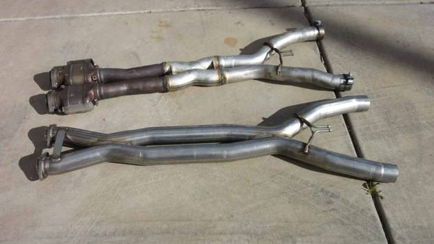

This is what the stock pipe looks like next to the Corsa.
At the end of the pipe closest to the cats, remove the donut gaskets from the flanges and save for re-use.
 In this photo, the donut gaskets on the flange are still in place.

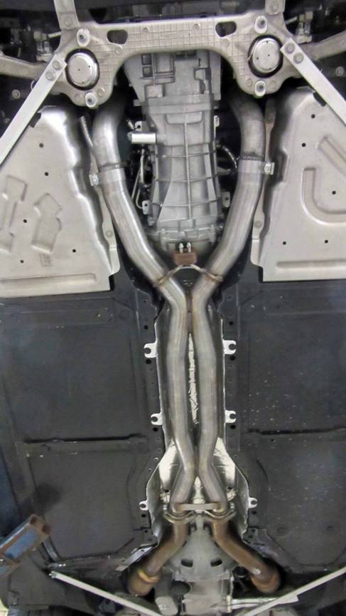

The pipe fit perfectly with no struggles or drama. This is what it looks like in place.
A picture containing old, sitting, bicycle, engine
Description automatically generated
You can see the double x in this picture. You can also see the rubber grommet on the hanger just in front of the transmission.
